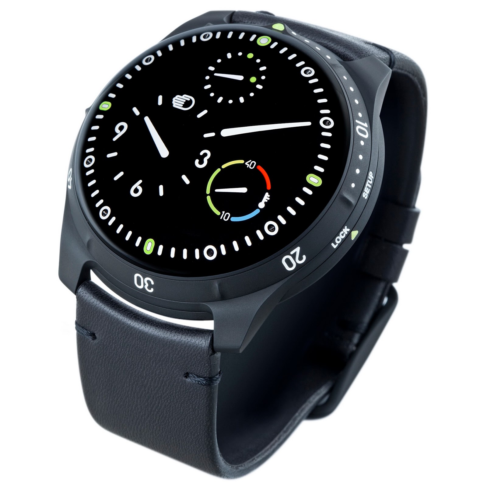

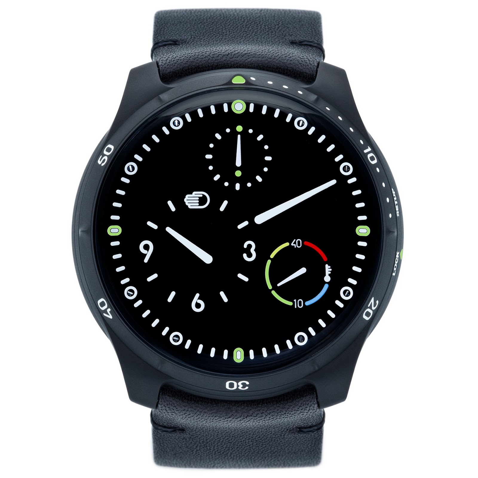

Instead, the hours, seconds and the oil temperature gauge sit in revolving discs, which in turn orbit inside the main disc of the minute display, which itself is continuously revolving - so this patented orbital display system is an integral part of the dial.
This complication is known as the ROCS or Ressence Orbital Convex System. It is a first in the history of watchmaking and employs a specially-modified 2824 automatic caliber that gives the minutes, and hence the base calculation of time, from which is extrapolated all the other temporal indications on the dial.

The TYPE 5 cleverly compensates the use of oil, as its volume in the watch will fluctuate with temperature. The watch is therefore fitted with a system of seven small bellows. These compress when, with rising temperature, the oil volume increases, or expand if the temperature drops and the volume decreases –
the result perfectly stabilizes the fit of the oil within the watch. The system is directly connected to the oil temperature gauge on the dial - so the TYPE-5 owner can see a representation of the bellows capacity in action.

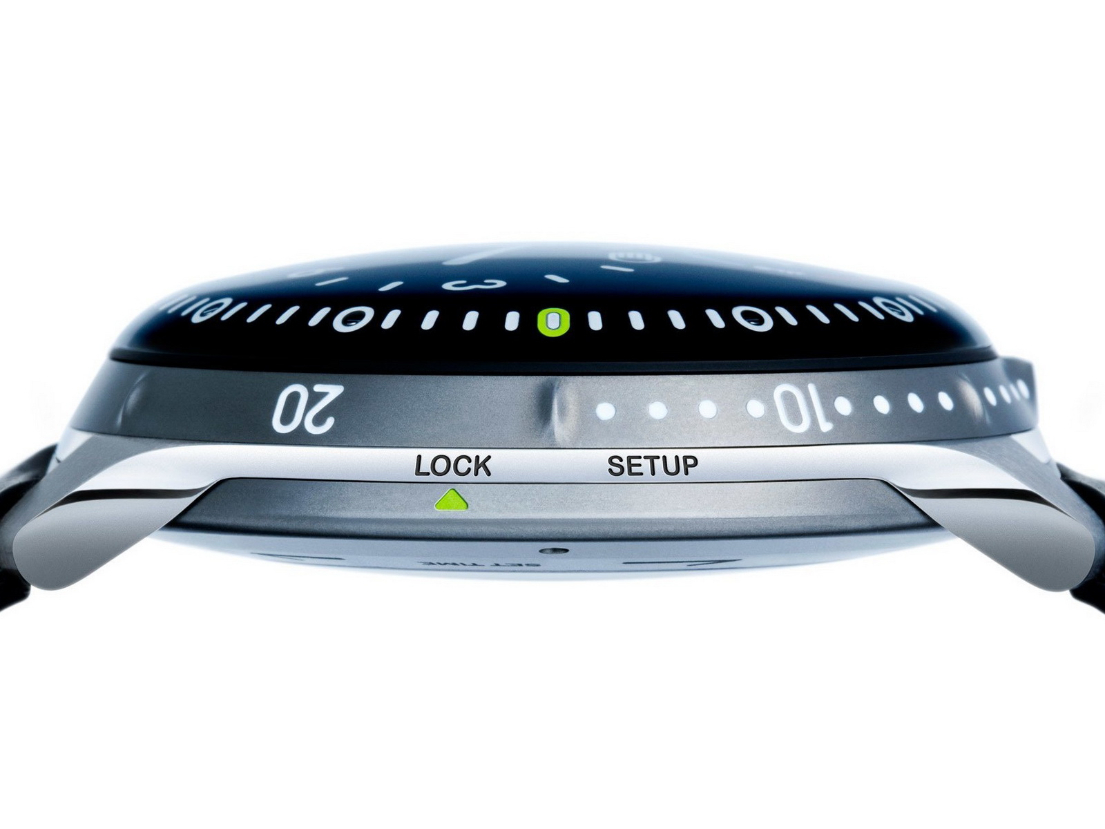

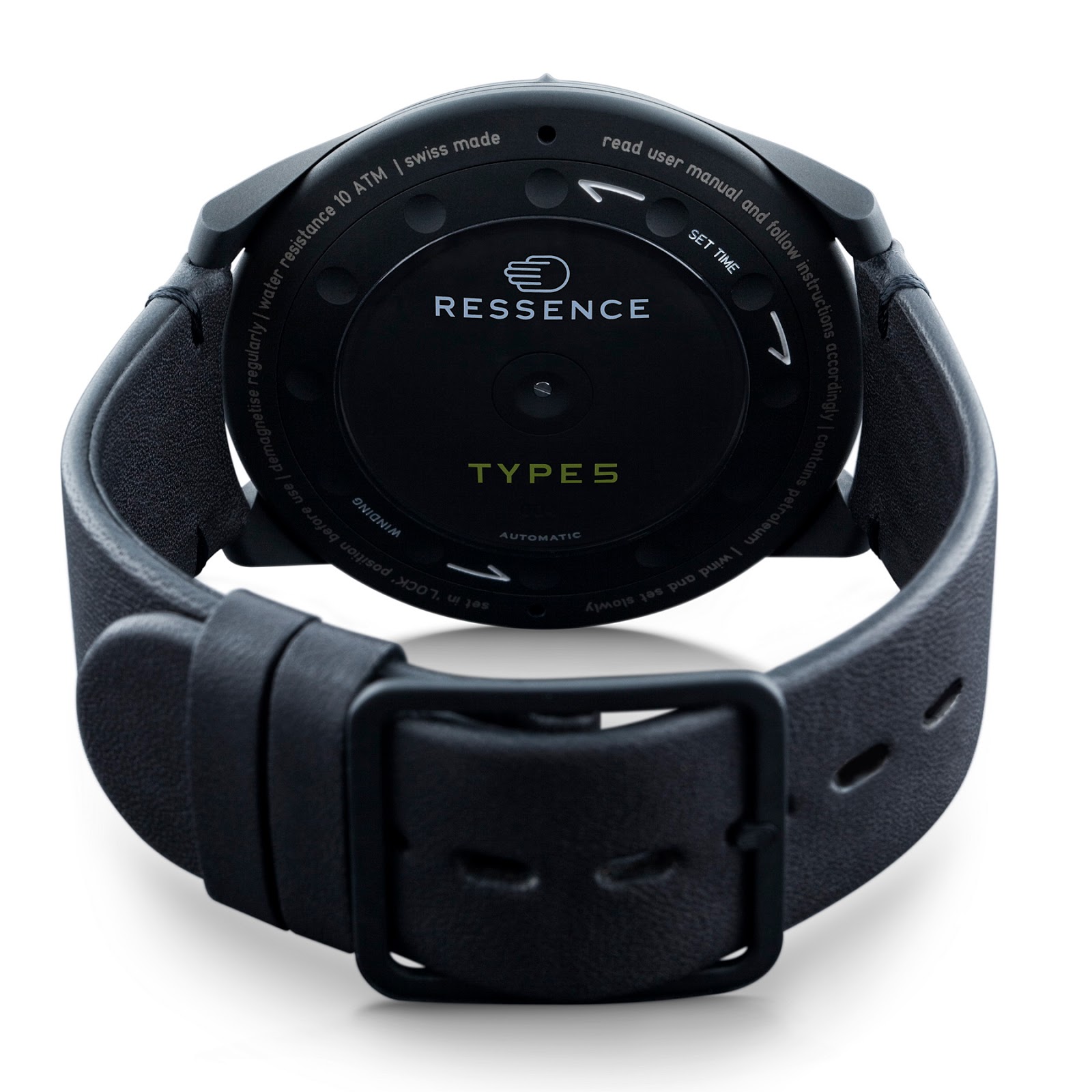

The TYPE-5 has no crown - rather, the caseback is used both for winding and setting the time of the watch. But, to ensure maximum water-resistance, a new case-back has been specially developed for the TYPE-5. Dubbed the Ressence Compression Lock System, or RCLS, it has a system for the locking and compression of the gasket, with two positions, ‘lock’ and ‘set’.
